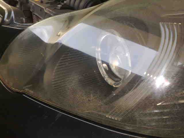

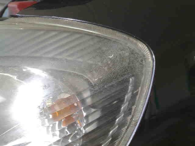

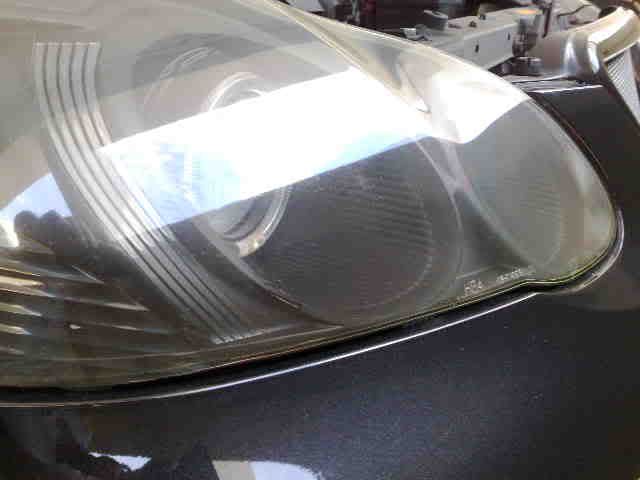

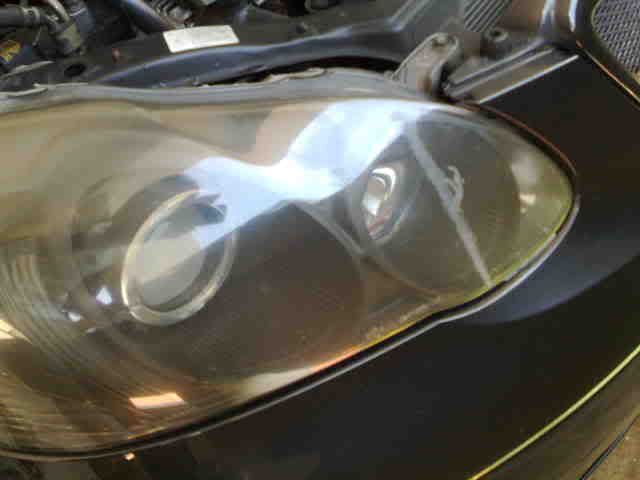

V200 Neutral Newbie June 13, 2010 Share June 13, 2010 After 3 years of having these lights, I finally could not take it anymore. When I bought this from the previous owner, it had many scratches and stains. I used to wash with glass cleaner, car soap. But still cannot remove. At the end, just left it. Then recently, googled and found that plastX could remove. Tried to find, but not readily available. Hence, since I had ScratchX, I gave it a try. Before (right lights) After (right lights) Before (left lights) After (left lights) It is not perfect, but 90% better. A lot of elbow grease needed. ↡ Advertisement Link to post Share on other sites More sharing options...

V200 Neutral Newbie June 14, 2010 Author Share June 14, 2010 PlastX Giant have or amk hub fairprice xtra also have. I used the meguiar's ultimate compound to polish my previous car headlights also quite effective. ha ha. Thanks. I went to SelfFix DIY, carrefour, cannot find. Anyhow, still have ScratchX lying around.So use it. Surprisingly, it works! Link to post Share on other sites More sharing options...
V200 Neutral Newbie June 14, 2010 Author Share June 14, 2010 Wow! Great difference. Very nice.... Thanks. but super tired. Lots of elbow grease required! Link to post Share on other sites More sharing options...
Kb27 Supersonic June 15, 2010 Share June 15, 2010 I got PlastX from Autobacs. ScratchX can be used, but I think you got to be careful on how much strength to use. The headlight covers are made of plastic. Any harsher compound may just scratch it and make it worse looking. Link to post Share on other sites More sharing options...
