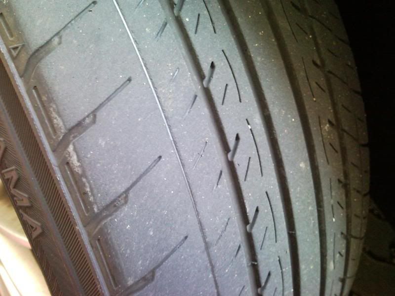

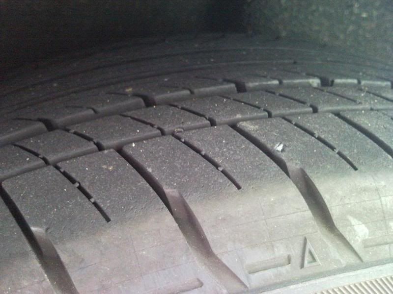

Titanium 4th Gear December 19, 2010 Author Share December 19, 2010 Hi all, Thanks for the advise... Sorry was bz these few weeks. Here is the pic of the front n rear tyres. The front ones must change hor? The Front. The Rear. Link to post Share on other sites More sharing options...

Pisces69 6th Gear December 19, 2010 Share December 19, 2010 Ok... i forgot to do tyre rotation for my 2.5yrs ride (33k mileage) as i didnt go back to the AD for servicing only oil change at outside workshop. I went to a workshop yesterday and they recommend me to change my front 2 tyres as they worn more than the rear (ok la... i dun think is as bad). They quoted me 2 x yoko 15" ES501 at $280... i have a few qns. - Should the new tyres mount to the front or rear? - Is $280 reasonable? - Hmm.... is it weird if i chose another brand like GR90? Thanks! Just mount e new tires in front n use fr 30k km till its wear is similar to e rear pair then do yr rotation every 10k km as usual. $280 fr 2 pcs seem expensive. Look around a better price 1st. My yoko A.Drives 205/45/16 only cost $115 ea. Try to stick wh same tire fr front n rear as far as possible. More even grip n wear. Noise also wil b different. Link to post Share on other sites More sharing options...
Titanium 4th Gear December 19, 2010 Author Share December 19, 2010 Just mount e new tires in front n use fr 30k km till its wear is similar to e rear pair then do yr rotation every 10k km as usual. $280 fr 2 pcs seem expensive. Look around a better price 1st. My yoko A.Drives 205/45/16 only cost $115 ea. Try to stick wh same tire fr front n rear as far as possible. More even grip n wear. Noise also wil b different. Hi... Care to share where u got ur Yoko? Thanks. Actually my plan is to mount the new tyres to the rear and move the old rear to the front, so that the old rear tyres will wear off faster since they already 2.5yrs old, i dun feel safe putting them behind. Link to post Share on other sites More sharing options...
Pisces69 6th Gear December 19, 2010 Share December 19, 2010 From what i have heard before, better tires at the back because if the front tires skid, you can still steer the car to gain control. But if the back wheel skid, it is very hard to control or got no control. so it is better to put the better tires at the back and the more "botak" tire in the front. If yr rear skid, u can counter steer to regain control. If yr front tires skid u hv no control of e car at all. FWD car, yr front tires wear faster cos ty do more work. Now u can even out e wear by putting e new tires in front to get yr front n rear tires to abt same wear, then u can do yr balance n rotation as per normal. ie. every 10k km. ↡ Advertisement Link to post Share on other sites More sharing options...
