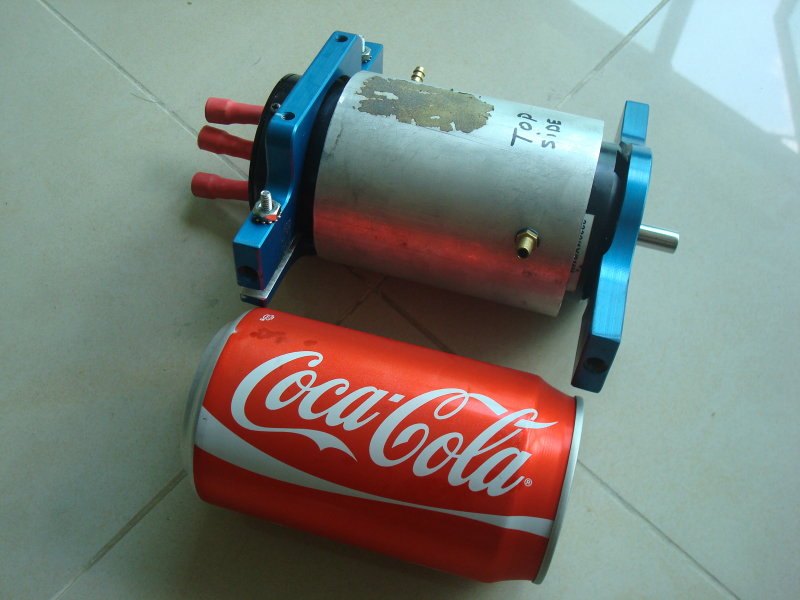

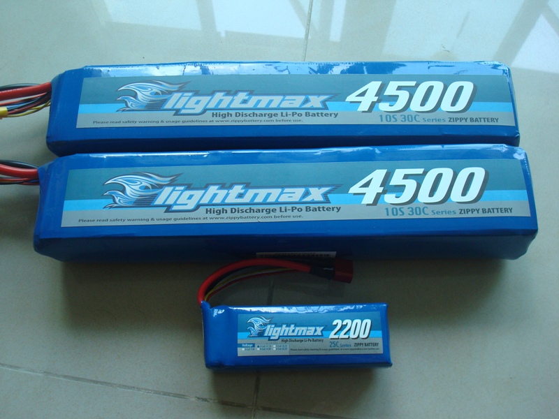

Adrianli Hypersonic July 13, 2011 Share July 13, 2011 Welcome to the world of r/c. I believe the battery packs we use for large r/c machines should be able to provide sufficient power for ur blender. U might even want to consider swapping the ac motor for a dc brushless motor. My "Coke Can" size motor for my r/c boat is capable of 10,000watts of power. Otherwise, get a 12V inverter from Sim Lim Tower and get a couple of 3S lipo 5000mah 30C batteries from r/c shop. Confirm to run ur blender. BTW, these are the batteries that run my motor, two of them parallel togather : Link to post Share on other sites More sharing options...
