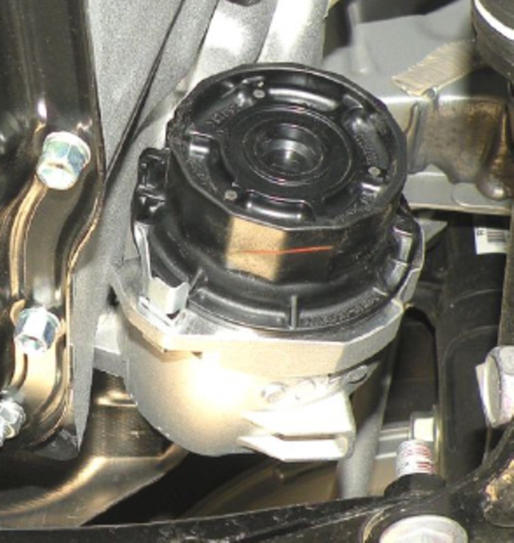

Yeobh 4th Gear July 17, 2011 Share July 17, 2011 (edited) Receive this info from friends - that Toyota Prius Hybrid & Corolla 1800 & 2000 cc are using plastic canister oil filter. To remove the canister, mechanic needs to exercise care and use the right tool to prevent damage to the plactic canister Edited July 17, 2011 by Yeobh Link to post Share on other sites More sharing options...
