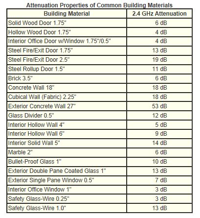

Happily1986 5th Gear October 25, 2011 Share October 25, 2011 Not sure if I understood correctly.. my plan is 16Mbps.. meaning if i use wireless...i will only be expecting ard half of that? If thats the case...I will have to seriously consider getting a contractor to lay and conceal the wiring... Thanks bro. After all that has been said and done, you will most probably be getting a router which supports 802.11n or 300Mbps N speed. The problem is that even though i quoted that the actual real world throughput is rated at 74Mbps, this is assuming that the signal strength is perfect with no interfence. Interference can arise from the following forms 1.) 2.4GHz interference from cordless phones, microwave ovens and baby monitors 2.) Neighbouring SSIDs from your neighbours' wireless network. Overcrowding. 3.) Natural interference due to infrastructural attenuation. The rule of the thumb is for every 3dB of interference attenuation, you lost 1/2 of your transmission power. Thats how bad radio propagation is! For peace of mind, going cat6 may be the best long term investment ever for hassle free usage. Link to post Share on other sites More sharing options...

Baphomet 3rd Gear October 25, 2011 Share October 25, 2011 After all that has been said and done, you will most probably be getting a router which supports 802.11n or 300Mbps N speed. The problem is that even though i quoted that the actual real world throughput is rated at 74Mbps, this is assuming that the signal strength is perfect with no interfence. Interference can arise from the following forms 1.) 2.4GHz interference from cordless phones, microwave ovens and baby monitors 2.) Neighbouring SSIDs from your neighbours' wireless network. Overcrowding. 3.) Natural interference due to infrastructural attenuation. The rule of the thumb is for every 3dB of interference attenuation, you lost 1/2 of your transmission power. Thats how bad radio propagation is! For peace of mind, going cat6 may be the best long term investment ever for hassle free usage. woah woah woah....sorry ar...u lost me there! Seriously if im gonna loose so much speed...I think i will consider upgrading to fibre optics (Suggested by bro J22) ... only thing is din noe they allow me to upgrade or not.. what about the wifi receiver? is it critical? ↡ Advertisement Link to post Share on other sites More sharing options...
