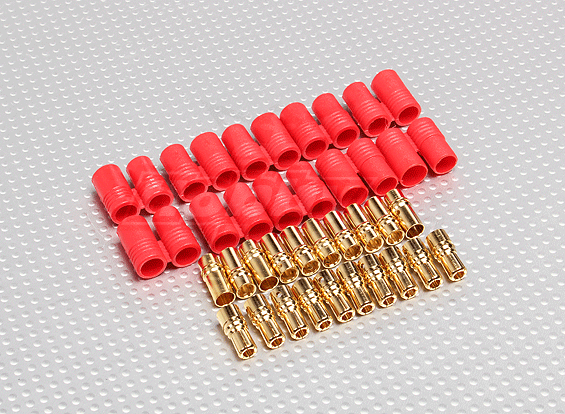

Adrianli Hypersonic June 27, 2013 Share June 27, 2013 (edited) Bro, might to pm/share with me what is required for the above you mentioned. ie: - connectors - which floor in SLT to purchase the batteries? etc TQ I get my stuff mostly from online hobby shop. http://www.hobbyking.com/hobbyking/store/index.asp Batteries here : Then I desolder the stock connectors and resolder with these, 6mm Gold Connectors, capable of 120-200A draw : Then make adapter to Deans connector for charging with my multi-chemistry charger : Then make another adapter for JST connectors. This connector go directly to the car cam. They are rated up to 10A, sufficient for car cam usage. This JST connector can be purchased at SLT, various shops at basement or level 3. Abt $1 to 1.20 per connector. Online, much cheaper. Edited June 27, 2013 by Adrianli Link to post Share on other sites More sharing options...
