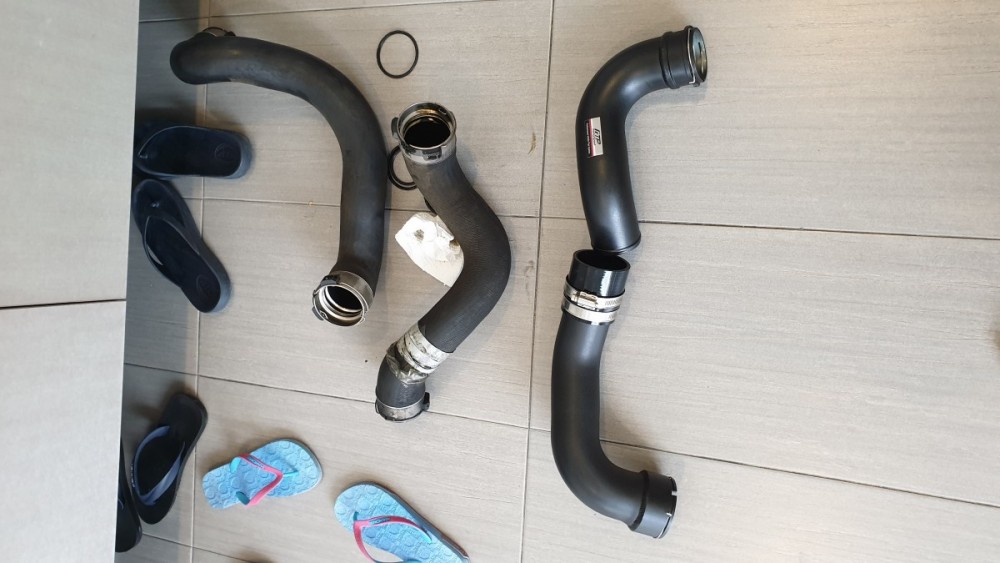

andrewyewkc 5th Gear September 23, 2020 Share September 23, 2020 On 4/5/2020 at 5:19 PM, Ct3833 said: Haha backside itchy. My son Went to order the whole set of Taiwan made alumni pipe , he just had it replaced. Hope it works. There may be a risk of bimetallic corrosion. https://en.wikipedia.org/wiki/Galvanic_corrosion 1 Link to post Share on other sites More sharing options...
Ct3833 Supersonic September 23, 2020 Share September 23, 2020 4 minutes ago, andrewyewkc said: There may be a risk of bimetallic corrosion. https://en.wikipedia.org/wiki/Galvanic_corrosion Haha thanks. Air hose only, but will check it out one day. 1 Link to post Share on other sites More sharing options...
