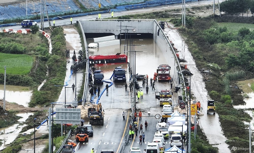

SGMCF328 Turbocharged July 17, 2023 Share July 17, 2023 (edited) Look like scene from Tunnel (Korean movie). Make me wonder how safe is our MRT tunnel, CTE, KPE, MCE and such. Are we well prepared for the worst case scenario, even if the chance of occurrence is 1 in 100 or even 1000 years? Source: https://www.channelnewsasia.com/asia/south-korea-floods-yoon-suk-yeol-failure-disaster-response-rules-death-toll-missing-3633441 SEOUL: South Korean President Yoon Suk-yeol on Monday (Jul 17) blamed authorities' failure to follow disaster response rules as the death toll from days of torrential rain grew to 39, including a dozen people found dead in a submerged underpass. The rains have pummelled the country's central and southern regions since Thursday as the rainy season that started in late June reaches its peak. The interior ministry has also reported nine people missing and 34 injured across the nation. Twelve deaths, including three bodies retrieved overnight, occurred in a tunnel in the central city of Cheongju, where 16 vehicles, including a bus, were swamped by a flash flood on Saturday after a river levee collapsed. Nine others were hurt. The incident fuelled questions over South Korea's efforts to prevent and respond to flood damage. Some drivers who use the road regularly blamed the government for failing to ban access to the underpass even though floods were widely forecast. According to Yonhap, South Korean police said they would launch an investigation into the fatal flooding of the underpass in Cheongju. Floods have claimed dozens of lives during recent rainy seasons as weather patterns have become more extreme. Yoon, just back from an overseas trip, on Monday convened an intra-agency meeting on disaster response and said the situation was made worse because of poor management of vulnerable areas. Ahead of a visit to flood-hit North Gyeongsang province on Monday, Yoon said: "This kind of extreme weather event will become commonplace - we must accept climate change is happening, and deal with it." The idea that extreme weather linked to climate change "is an anomaly and can't be helped needs to be completely overhauled", he said, calling for "extraordinary determination" to improve the country's preparedness and response. South Korea will "mobilise all available resources" including the military and police to help with rescue efforts, he said. Edited July 17, 2023 by SGMCF328 ↡ Advertisement 3 2 1 Link to post Share on other sites More sharing options...

BanCoe Hypersonic July 17, 2023 Share July 17, 2023 Looking at the ohoto of the tunnel ( or how it was constructed …… the tunnel is going downwards and must have become a pool and sudden downpour might have just been overwhelming or river water inside …… don’t we all feel relief when going into a tunnel on a heavy downpour ……. Not knowing that it can also be a trap if the pumps malfunction or can’t cope with deluge or gradient is off …… Expensive lesson to learn …… I’m sure our engineers in LTA will take cognizance in the MCE tunnel too as it’s near the sea / barrage too 1 Link to post Share on other sites More sharing options...
