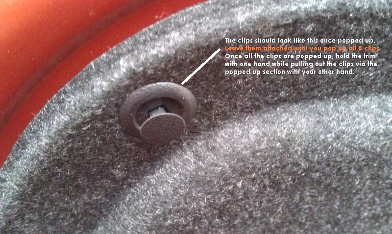

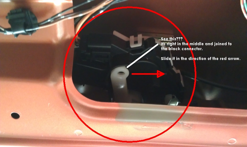

Elfenstar 3rd Gear January 7, 2012 Share January 7, 2012 (edited) Nop, used the original key that came with the car. No alarm. Thank u for ur help Ok you have two options. a) Take it to a mechanic b) DIY to toubleshoot, and if under the boh bian act and everything is connected, take it to the mechanic, or DIY a change in mechanism. If 2, here's how you can check. Step 1- In your case, you first need to bring down your back seat and remove everything from your boot. The rear parcel shelf cannot be popped up so you will need to squeeze in. You will also need a torchlight. Step 2- Remove the rear trim Step 3- Push all connectors together, and check all connections to make sure they are secure. Make sure none of the wires have popped out of the connectors. I've circled the four of them in the images below. As I took the pictures with the boot open and facing in towards the car, they are from left to right. However in your case they should be right to left. Step 4- Test the button now. Ask someone else to press the button while you look at the mechanism circled in the image below. If it works then you can skip to step 5. If the white thing in the image moves but the hatch doesn't open, it means your hatch is stuck to the frame. The white thing will also snap back to its original position after a short while. If not then try and manually release the hatch. Use a little strength, but not too much. If it doesn't move, then either the mechanical lock or the motor has jammed up. It it does, then there's a problem with the electrics either in the button, the motor, or someone further upstream of the hatch. Either way you'll have to have someone do the work. So, put all 8 clips in a bag, and keep them and the trim safe somewhere while you take your car to a mech. Step 5- Re-assembly. If its working, hold the trim in place, and while you hold the popped up section, push the clips though the holes in the trim and into the hatch. Start with the four at the edges, then the four in the middle. Once done all the clips should look like in image 002 Now just push all the popped up bits in. Edited January 7, 2012 by Elfenstar Link to post Share on other sites More sharing options...
