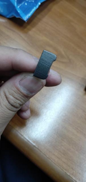

Wil Clutched January 14, 2019 Share January 14, 2019 (edited) The water is found below this molded tray. To be fair, before I bought this car. I have also checked other stream and realise there are 2 other stream I have seen also have water this area. Therefore would like to know whether it’s normal since we won’t normally open up and check for water since the car interior lining and seats are all dry... Edited January 14, 2019 by Wil Link to post Share on other sites More sharing options...
QQDreamer 4th Gear January 14, 2019 Share January 14, 2019 (edited) The water is found below this molded tray. To be fair, before I bought this car. I have also checked other stream and realise there are 2 other stream I have seen also have water this area. Therefore would like to know whether it’s normal since we won’t normally open up and check for water since the car interior lining and seats are all dry... not normal. there should be some leakage somewhere. the molded tray should be dry. Edited January 14, 2019 by StreamRSZ Link to post Share on other sites More sharing options...
