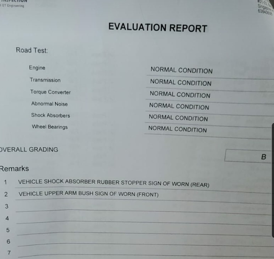

jeffchiang Clutched January 7, 2021 Share January 7, 2021 (edited) Hi all, just bought a 2nd hand car (5 year old, 62k mileage) and sent for STA evaluation. Grading is B with the following remarks: 1) VEHICLE SHOCK ABSORBER RUBBER STOPPER SIGN OF WORN (REAR) 2) VEHICLE UPPER ARM BUSH SIGN OF WORN (FRONT) Engine, Transmission, Torque Converter, Abnormal Noise, Shock Absorbers and Wheel Bearings all normal condition. Should I be concerned about the above remarks? Thanks! 🙂 Edited January 7, 2021 by jeffchiang ↡ Advertisement 1 Link to post Share on other sites More sharing options...

Watwheels Supersonic January 7, 2021 Share January 7, 2021 (edited) 1 hour ago, jeffchiang said: Hi all, just bought a 2nd hand car (5 year old, 62k mileage) and sent for STA evaluation. Grading is B with the following remarks: 1) VEHICLE SHOCK ABSORBER RUBBER STOPPER SIGN OF WORN (REAR) 2) VEHICLE UPPER ARM BUSH SIGN OF WORN (FRONT) Engine, Transmission, Torque Converter, Abnormal Noise, Shock Absorbers and Wheel Bearings all normal condition. Should I be concerned about the above remarks? Thanks! 🙂 Why is everyone focused on the shock absorber? Any further details on the abnormal noise? The way you put it is confusing. Does it mean the engine, transmission and the torque converter have abnormal noise? Shouldnt you pay more attention to that? Edited January 7, 2021 by Watwheels Link to post Share on other sites More sharing options...

jeffchiang Clutched January 7, 2021 Author Share January 7, 2021 Mileage wise I've checked with agent that based on last servicing in Nov 2020 it's quite close so shouldn't have been tampered with. Sorry if I sound confusing. The engine and all found to be in normal condition. Attached an extract of the report. 2 Link to post Share on other sites More sharing options...
Rickster 5th Gear January 7, 2021 Share January 7, 2021 24 minutes ago, jeffchiang said: Mileage wise I've checked with agent that based on last servicing in Nov 2020 it's quite close so shouldn't have been tampered with. Sorry if I sound confusing. The engine and all found to be in normal condition. Attached an extract of the report. From just this list, it seems that all is normal and expected. Link to post Share on other sites More sharing options...

Watwheels Supersonic January 7, 2021 Share January 7, 2021 54 minutes ago, jeffchiang said: Mileage wise I've checked with agent that based on last servicing in Nov 2020 it's quite close so shouldn't have been tampered with. Sorry if I sound confusing. The engine and all found to be in normal condition. Attached an extract of the report. This is a clearer picture. You should be ok. Link to post Share on other sites More sharing options...
