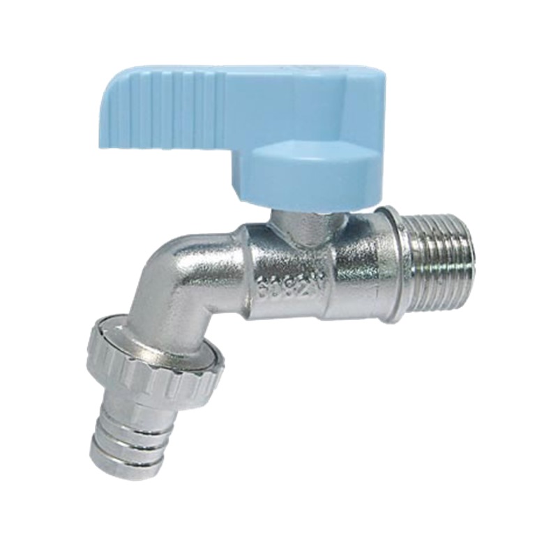

Mkl22 Supersonic November 4, 2023 Share November 4, 2023 (edited) If you tighten this tapered seal without the thread seal it will still leak. So it does seal the threads and does seal. it’s like those garden taps that you screw into the wall. Need to put lots of tape. Edited November 4, 2023 by Mkl22 ↡ Advertisement Link to post Share on other sites More sharing options...
