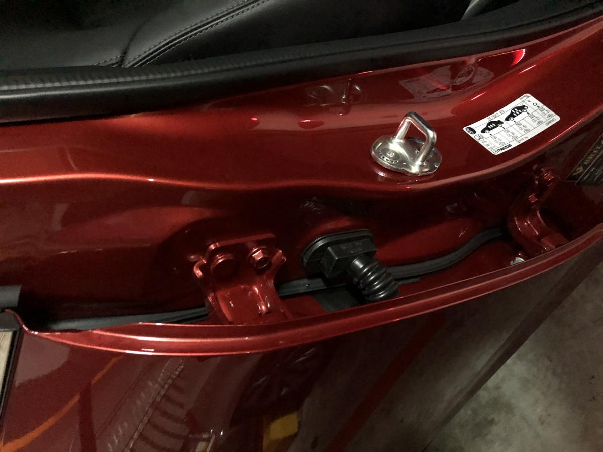

S2s1 3rd Gear December 21, 2018 Share December 21, 2018 (edited) Arrived! Going to install the door frame bottom part first. Thanks again bro Richard! Good lobang! Edited December 21, 2018 by S2s1 2 Link to post Share on other sites More sharing options...
S2s1 3rd Gear December 21, 2018 Share December 21, 2018 Very easy to install. Link to post Share on other sites More sharing options...
richard_crl032 6th Gear December 22, 2018 Share December 22, 2018 (edited) Very easy to install.Hi s2s1, Cool ! For next bros fixing this door seal, you may want to cut it longer at the bottom to go over the tapered end and onto the lowest part .. albeit probably not critical .. dunno. Bro s2s1 can probably still add the excess seal to this bottom lowest part but not sure how well it will hold up since already cut ... sorry I was not clear in initial share. For the centre seal, pls adjust it for the highest portion to be about 3mm the stock seal of rear door rest on ... else opening rear door may flip its stock seal backward which will not be the best sealing. And yes, pls adjust placement and do not press down until top and bottom ia about mentioned 3mm cos this genuine 3M tape is quite strong but you can remove and reposition quite a few times. Cheers. Richard Just realised i cant insert any link lolHi soul, Start link with << and end with >> and your link should show. Cheers. Richard Edited December 22, 2018 by richard_crl032 1 Link to post Share on other sites More sharing options...
S2s1 3rd Gear December 22, 2018 Share December 22, 2018 Hi s2s1, Cool ! For next bros fixing this door seal, you may want to cut it longer at the bottom to go over the tapered end and onto the lowest part .. albeit probably not critical .. dunno. Bro s2s1 can probably still add the excess seal to this bottom lowest part but not sure how well it will hold up since already cut ... sorry I was not clear in initial share. For the centre seal, pls adjust it for the highest portion to be about 3mm the stock seal of rear door rest on ... else opening rear door may flip its stock seal backward which will not be the best sealing. And yes, pls adjust placement and do not press down until top and bottom ia about mentioned 3mm cos this genuine 3M tape is quite strong but you can remove and reposition quite a few times. Cheers. Richard Hi Richard, For the bottom door seal, I fix them along the rear door metal and tried to cover as much as possible. The most top and bottom metal is slanted so I thought the rubber will be not fixed properly, so I stop at the slanted point. For the top door seal, I do not understand. Do you mean we give 3mm allowance to the rear door stock seal? Link to post Share on other sites More sharing options...

Johnypg 1st Gear December 23, 2018 Share December 23, 2018 Hi bros, Received and installed the door seal from Japan ... alleviated say 70% of the wind noise from behind front passenger and driver even with audio system switched off. <<https://www.sendico.com/auction/search?q=%E9%9D%99%E9%9F%B3%E8%A8%88%E7%94%BB+%E3%82%A8%E3%83%BC%E3%83%A2%E3%83%B3+2652+&part_id=0>> While the typical 2 layer rubber door seals are the same, the mazda design us less elaborate in letting wind into door void in the first place .. pls see photos where metal ledge does not all up all the way. Btw, did not change eo at 1k service since indeed almost sgd200 and will do so at 5k then. The engine of my mazda 2.0 exrcutive remains vocal and still the biggest source of noise especially with much less tyre noise with new michelin primacy 4 ST but less rough sounding at 1500km travelled. Still deliberating if to proceed with 2nd installation of Dr. Artex Red Wind ... this time on the chassis rubber insulation .. it seems that it is not flat against the chassis and seems not useful for such design. Cheers. Richard Will give it a try too! really?..thought they would change the engine oil too. 1st oil change only at 10,000 km. 2 Link to post Share on other sites More sharing options...

Dna_engine 3rd Gear December 23, 2018 Share December 23, 2018 Very easy to install. Bought mine from Alliexpress - SG$ 13.26 https://s.click.aliexpress.com/e/c6UOnNtI This has a metal piece in the rubber, so it can be bent to fit the curve of the door - see photo. ↡ Advertisement 1 Link to post Share on other sites More sharing options...
