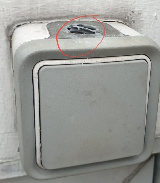

Ct3833 Supersonic August 20, 2021 Share August 20, 2021 (edited) Heavy rain the whole night, ended up my door bell went ding dong none stop because of water sippage, I have to resort to "crawling " up a ladder to unmount the batteries early in the morning. Went to buy a new Legrand outdoor doorbell button casing. The two rubber seals of the existing one are badly damaged. Put back the new one. Looks ok so far, the wire seems to be a littel damaged, hope no more short circuit when it rains. Edited August 20, 2021 by Ct3833 5 Link to post Share on other sites More sharing options...
Othello Supersonic August 20, 2021 Share August 20, 2021 (edited) Should have used for a long time ya? Rubber disintegrate liao. Do remember to put silicone around the switch. Edited August 20, 2021 by Othello 2 Link to post Share on other sites More sharing options...
Ct3833 Supersonic August 20, 2021 Share August 20, 2021 (edited) 3 hours ago, Othello said: Should have used for a long time ya? Rubber disintegrate liao. Do remember to put silicone around the switch. Not really, the most 2 or 3 year. These rubber get deteriorated very fast under hot sun, I bought a similar casing before just to use the 2 rubber seals but now I decided to replace the entire casing now. Maybe have to look for more lasting one. Yes applied silicone at the back around the edges. Thanks Edited August 20, 2021 by Ct3833 2 Link to post Share on other sites More sharing options...
