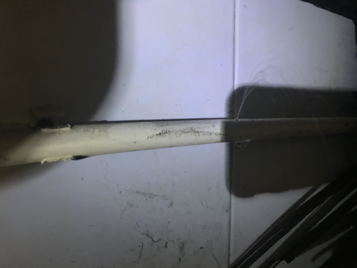

mersaylee Hypersonic December 1, 2019 Share December 1, 2019 Gungho on a Sunday. Thought it’s just an usual choke which I’ve resolved before... ...found a fountain behind the cabinet panel... Any recommendation for a Reliable plumber anyone? TIA. Link to post Share on other sites More sharing options...
Wallaw819 4th Gear December 1, 2019 Share December 1, 2019 easiest is to get a union, cut off the leaking portion and install the union. done. 2 Link to post Share on other sites More sharing options...
mersaylee Hypersonic December 1, 2019 Share December 1, 2019 30 minutes ago, Wallaw819 said: easiest is to get a union, cut off the leaking portion and install the union. done. PVC would be easy but this one is copper painted white 😅 Link to post Share on other sites More sharing options...
Volvobrick Supersonic December 1, 2019 Share December 1, 2019 (edited) Is that copper or pvc? If you cut it, can the left portion be moved slightly to install either a pvc coupling or brass compression coupling for copper pipe? That's easy DIY, provided the left side can be moved slightly and you have some basic tools. The plumber might just solder it if it's copper pipe. While I may just try cutting a piece of rubber from old inner tire and secure with a hose clip if both sides are not movable, till the whole kitchen is renovated! Edited December 1, 2019 by Volvobrick 1 Link to post Share on other sites More sharing options...
mersaylee Hypersonic December 1, 2019 Share December 1, 2019 26 minutes ago, Volvobrick said: Is that copper or pvc? If you cut it, can the left portion be moved slightly to install either a pvc coupling or brass compression coupling for copper pipe? That's easy DIY, provided the left side can be moved slightly and you have some basic tools. The plumber might just solder it if it's copper pipe. While I may just try cutting a piece of rubber from old inner tire and secure with a hose clip if both sides are not movable, till the whole kitchen is renovated! It’s copper...yet can have pin hole leak... I hope to be able to find time tomorrow for silicon patch and a ring clamp as temp fix. I’m now worried about the running pipe high up in the concealed top hung kitchen cabinet... 😅 1 Link to post Share on other sites More sharing options...
Kb27 Supersonic December 1, 2019 Share December 1, 2019 Self fusing silicone tape. Everyone should have one. 4 Link to post Share on other sites More sharing options...
mersaylee Hypersonic December 1, 2019 Share December 1, 2019 (edited) 18 minutes ago, Kb27 said: Self fusing silicone tape. Everyone should have one. Ran out of those...I thought I still have the last yellow 😂 Edited December 1, 2019 by mersaylee Link to post Share on other sites More sharing options...
Volvobrick Supersonic December 1, 2019 Share December 1, 2019 1 hour ago, mersaylee said: It’s copper...yet can have pin hole leak... I hope to be able to find time tomorrow for silicon patch and a ring clamp as temp fix. I’m now worried about the running pipe high up in the concealed top hung kitchen cabinet... 😅 Happened to me before. Old copper pipe with pinhole leak like your photo.... in the concealed ceiling board! That job I outsourced cos got to cut open the ceiling and then patch back. ↡ Advertisement Link to post Share on other sites More sharing options...
