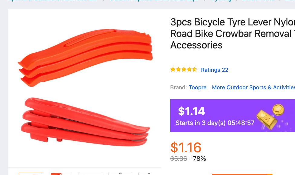

SIM37 4th Gear July 3 Share July 3 (edited) On 7/3/2025 at 1:07 PM, Lala81 said: 14 or 15mm for the nut, to remove the wheel But judging from the pic, I think its just deflated, all you need to do is pump it up. Other things that you may need to check if u pump and it doesn't inflate = Inner tube either got hole or cui liao. If inner tube cui. This looks like a 14" tube. https://s.lazada.sg/s.XUWrP (Shouldn't cost u more than $4) You will also need a tyre lever to remove the outside tyre to access the inner tube. https://s.lazada.sg/s.XUWIo (Under $3) https://s.lazada.sg/s.XUWIo Inside it, you "might" need to get rim tape if it also is cui https://s.lazada.sg/s.XUWss But very likely, its just poncheck nia. Pump it up to 30-40psi. it should be all gd. Edited July 3 by SIM37 4 Link to post Share on other sites More sharing options...
