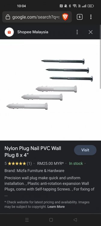

Bluepica 4th Gear November 7, 2022 Share November 7, 2022 Hi hi, My wall hanging shoe rack is like dropping off from the wall soon cos the gap between the cabinet and the wall is getting huge till the sealant have been torn off from the wall. The shoe rack is quite huge (7' x 2.5') but I saw it is only fastened by 8 screws to the wall (4 top and 4 bottom)... and our HDB wall bricks are quite hollow, the screws and wall plug might get loosened over time. Question : How do I add in additional screws to tightened the cabinet back to the wall? I saw carpenter usually use those long screws that have a white color wall plug attached to it. What do you call those screws? Do I need to use a wood drill bits to drill the cabinet till it reaches the wall and then continue with a concrete drill bit OR can I just use a concrete drill bit to drill the cabinet all the way into the wall, then plug in the screw with wall plug? What size of the drill bit and the screw with wall plug should I look for (length x width) ? Thanks for the DIY guru here. ↡ Advertisement Link to post Share on other sites More sharing options...

Beregond Supersonic November 7, 2022 Share November 7, 2022 1 hour ago, Bluepica said: Hi hi, My wall hanging shoe rack is like dropping off from the wall soon cos the gap between the cabinet and the wall is getting huge till the sealant have been torn off from the wall. The shoe rack is quite huge (7' x 2.5') but I saw it is only fastened by 8 screws to the wall (4 top and 4 bottom)... and our HDB wall bricks are quite hollow, the screws and wall plug might get loosened over time. Question : How do I add in additional screws to tightened the cabinet back to the wall? I saw carpenter usually use those long screws that have a white color wall plug attached to it. What do you call those screws? Do I need to use a wood drill bits to drill the cabinet till it reaches the wall and then continue with a concrete drill bit OR can I just use a concrete drill bit to drill the cabinet all the way into the wall, then plug in the screw with wall plug? What size of the drill bit and the screw with wall plug should I look for (length x width) ? Thanks for the DIY guru here. from what u say, all the holes already drill , but i think got loosen over time. U see this photo , 1 of the bro post u need to replace the white colour plastic casing, try to find the correct size, it must be very very very tight, U will need a bit of hammer to force the casing into the hole. then just use the screw and screw it in can already . Dun over tighten the screw, u see the rack is stable can already , some wall is very hollow. Try not to make new holes or enlarge those holes on the wall, the more u drill, the bigger and worst it get. Link to post Share on other sites More sharing options...

Lala81 Hypersonic November 7, 2022 Share November 7, 2022 (edited) 12 minutes ago, Beregond said: from what u say, all the holes already drill , but i think got loosen over time. U see this photo , 1 of the bro post u need to replace the white colour plastic casing, try to find the correct size, it must be very very very tight, U will need a bit of hammer to force the casing into the hole. then just use the screw and screw it in can already . Dun over tighten the screw, u see the rack is stable can already , some wall is very hollow. Try not to make new holes or enlarge those holes on the wall, the more u drill, the bigger and worst it get. Actually I have a whole box of these somewhere in my storeroom. Can't find it offhand. Left over from my unit previous owner Reno. They are not the ones holding to the wall. They are much smaller. Maybe they use this for lower cabinets Edited November 7, 2022 by Lala81 1 Link to post Share on other sites More sharing options...
