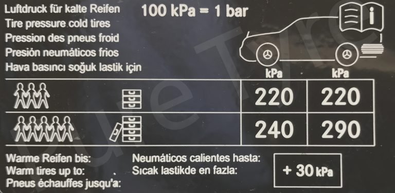

Vratenza Supersonic September 25, 2018 Share September 25, 2018 This a a sample pressure table for GLC. Usually when fully laden, the rear pressure recommended to go up disproportionately to the front. This is because the max is 2 pax while the rear is 3 pax and trunk/boot full of luggage/cargo. Note 1: the Tire Pressure Cold Tires Note 2: Warm tires to add up to +30kPa So for my purpose, I usually pump after a long drive to the kiosk, so I will usually just pump 260kPa front and 280kPa rear to control/adujust the vehicle handling based on my staggered 20" non-RFT. Play around with the pressure to achieve the road holding characteristic to your liking. Link to post Share on other sites More sharing options...
Vratenza Supersonic September 25, 2018 Share September 25, 2018 is your car front wheel drive?the recommended front pressure seem to be higher than the rear. Maybe mine old man car no need so much air ba Link to post Share on other sites More sharing options...
Mkl22 Supersonic September 25, 2018 Share September 25, 2018 This a a sample pressure table for GLC. Usually when fully laden, the rear pressure recommended to go up disproportionately to the front. This is because the max is 2 pax while the rear is 3 pax and trunk/boot full of luggage/cargo. Note 1: the Tire Pressure Cold Tires Note 2: Warm tires to add up to +30kPa So for my purpose, I usually pump after a long drive to the kiosk, so I will usually just pump 260kPa front and 280kPa rear to control/adujust the vehicle handling based on my staggered 20" non-RFT. Play around with the pressure to achieve the road holding characteristic to your liking. Ya tire pressures are the best free mod. Link to post Share on other sites More sharing options...

inlinesix Hypersonic September 25, 2018 Share September 25, 2018 This a a sample pressure table for GLC. Usually when fully laden, the rear pressure recommended to go up disproportionately to the front. This is because the max is 2 pax while the rear is 3 pax and trunk/boot full of luggage/cargo. Note 1: the Tire Pressure Cold Tires Note 2: Warm tires to add up to +30kPa So for my purpose, I usually pump after a long drive to the kiosk, so I will usually just pump 260kPa front and 280kPa rear to control/adujust the vehicle handling based on my staggered 20" non-RFT. Play around with the pressure to achieve the road holding characteristic to your liking. What's stock tyre load index as per this label? ↡ Advertisement Link to post Share on other sites More sharing options...
