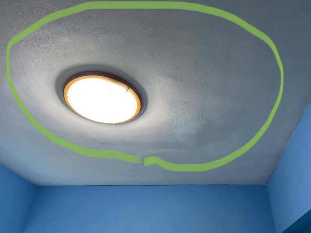

Ody_2004 Turbocharged August 13, 2021 Share August 13, 2021 Any one can recommend a expert ceiling crack repair expert? My son room ceiling seem the plastering can come down anytime.. 3 Link to post Share on other sites More sharing options...
t0y0ta Supercharged August 13, 2021 Share August 13, 2021 55 minutes ago, Ody_2004 said: Any one can recommend a expert ceiling crack repair expert? My son room ceiling seem the plastering can come down anytime.. If HDB, you can escalate to HDB first, especially for ceiling they will take it quite seriously. 1 Link to post Share on other sites More sharing options...
Hamburger Hypersonic August 13, 2021 Share August 13, 2021 NPNT. Easier to see with pix!! Link to post Share on other sites More sharing options...
Victor68 Turbocharged August 13, 2021 Share August 13, 2021 Concrete ceiling slab plaster crack means corrosion to reinforcement bar liao. Need to treat cause before replastering, otherwise it is a perpetual problem. 1 Link to post Share on other sites More sharing options...
Ody_2004 Turbocharged August 13, 2021 Share August 13, 2021 (edited) 6 hours ago, Hamburger said: NPNT. Easier to see with pix!! 7 minutes ago, Victor68 said: Concrete ceiling slab plaster crack means corrosion to reinforcement bar liao. Need to treat cause before replastering, otherwise it is a perpetual problem. I think not to the extend need reinforcement blah.. guess is water slippage from the external wall for the 20 years old apartment. Not easy to see from pic Edited August 13, 2021 by Ody_2004 1 Link to post Share on other sites More sharing options...
Victor68 Turbocharged August 14, 2021 Share August 14, 2021 You need to remove all loose plarer' treat the corroded bar with anti corrosion paint before replastering. Of course the leak or dampness muat stop. Otherwise spalling will appear in no time again. 2 Link to post Share on other sites More sharing options...
Kb27 Supersonic August 14, 2021 Share August 14, 2021 1 hour ago, Ody_2004 said: I think not to the extend need reinforcement blah.. guess is water slippage from the external wall for the 20 years old apartment. Not easy to see from pic Light without electrical wires...is it hidden inside (plaster) or false ceiling ? Link to post Share on other sites More sharing options...
Ody_2004 Turbocharged August 14, 2021 Share August 14, 2021 8 minutes ago, Kb27 said: Light without electrical wires...is it hidden inside (plaster) or false ceiling ? Plaster wor.. Link to post Share on other sites More sharing options...
Kb27 Supersonic August 14, 2021 Share August 14, 2021 Seems to me, like have to chip the plaster and find out where the leak source is, and fixed it. Link to post Share on other sites More sharing options...
Didu Turbocharged August 14, 2021 Share August 14, 2021 Any option to knock out the ceiling and covert to high ceiling? 😁 1 1 Link to post Share on other sites More sharing options...
Ody_2004 Turbocharged August 14, 2021 Share August 14, 2021 49 minutes ago, Kb27 said: Seems to me, like have to chip the plaster and find out where the leak source is, and fixed it. Yup i think so.. i bo contact leh.. Link to post Share on other sites More sharing options...
Hamburger Hypersonic August 14, 2021 Share August 14, 2021 Could it be leakage from poor waterproofing from upstair? No point patch it up when the main source is not resolved. Link to post Share on other sites More sharing options...
