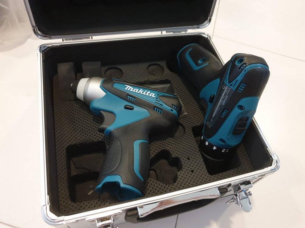

Kb27 Supersonic October 4, 2021 Share October 4, 2021 10 hours ago, Lala81 said: https://www.horme.com.sg/product.aspx?id=2514 It's a pretty good pricing. Last time I buy one piece already $200, I had to choose either one and I got the impact driver. Only later I was able to get drill, but that a Milwaukee. Link to post Share on other sites More sharing options...

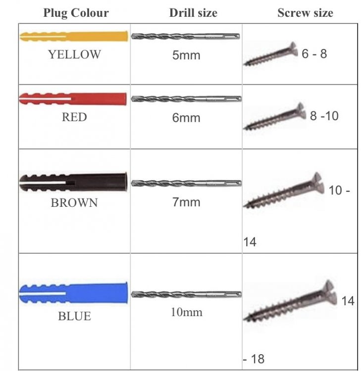

Mkl22 Supersonic October 4, 2021 Share October 4, 2021 55 minutes ago, Lala81 said: If i am putting some screws to hang wall clocks. It's ok to get these 5mm x 30mm anchors/plugs. Then i will need ? M5 screws?https://www.lazada.sg/products/cic-nylon-wall-anchor-plug-5x33mm-200pieces-i1790855438-s9347600337.html?spm=a2o42.searchlist.list.10.4c457ebbBk5Atq&search=1&freeshipping=1 Wah this home DIY stuff is actually quite complex lol. Don’t think your drill has the impact function. So cannot drill concrete. anyway for clocks and typical 1-2kg stuff 25mm depth is more than enough. Unless you have the rotary drills too deep will take time. 1 Link to post Share on other sites More sharing options...
Kb27 Supersonic October 4, 2021 Share October 4, 2021 34 minutes ago, Lala81 said: If i am putting some screws to hang wall clocks. It's ok to get these 5mm x 30mm anchors/plugs. Then i will need ? M5 screws?https://www.lazada.sg/products/cic-nylon-wall-anchor-plug-5x33mm-200pieces-i1790855438-s9347600337.html?spm=a2o42.searchlist.list.10.4c457ebbBk5Atq&search=1&freeshipping=1 Wah this home DIY stuff is actually quite complex lol. For home usage, you can get by with M6 plugs. Very cheap at Horme. 100 pcs/box for $1.05 (only 1 cent each). https://www.horme.com.sg/product.aspx?id=1842 Then get some screws of various length there. 1-1/4" is most common for many (wood) jobs, but you need to measure/gauge the length of the screw needed. You may also need 1", 2" screws, again depending on the job. Let's say you want to make a hole in the concrete wall to hang a clock. The clock is light, so you don't need heavy stuffs. Make a 6mm hole, then insert the M6 plugs. The hole depth must be slightly longer/deeper than the wall plug length, but not too deep until the whole plug sink into it. So if the plug is 3cm length, make roughly 3.5 to 4mm deep hole. The screw you need will be about 3 to 4 mm in diameter, and longer than 3cm. Giving the plastic plug 1mm of space on either side, that's roughly the diameter of the screw it takes. When you buy the box of M6 Fisher plugs, there's a label of instruction printed on the box. Try to follow it. I do not recommend other types of plugs due to bad experience, only the Fisher plugs. It's dirt cheap. The screw must go in all the way down the Fisher plug to split it and wedge against the concrete, so it's tightened and will not move. Then the exposed length of the screw should be long enough to hold the clock or whatever job. That's why you need to gauge the length of the screws needed. So really all you need is only a M6 masonry bit, the M6 Fisher plugs and the correct screws (diameter/length). For bigger jobs like hanging a TV wall mount, then you need to go higher like M10 plugs/bits and the correct screws. You'll learn little by little, don't worry. 😀 Oh, and for drilling into hdb concrete walls, you may need a rotary hammer drill. 3 Link to post Share on other sites More sharing options...

Kb27 Supersonic October 4, 2021 Share October 4, 2021 Screw size is another complicated subject. Some people use numbers like #6, #8..etc. It refers to American size gauge. Roughly I'll half the number to get the diameter in mm. or you can use a conversion chart. And never buy slotted head screws, they should be thrown away and banned. It's dangerous, bcuz the driver can slip easily out of the slot while you're driving and you may hurt yourself. Min. is the phillips screw head. Better head types are Robertson or Square, or Torx, but these screws are slightly more expensive and less readily available. 1 Link to post Share on other sites More sharing options...
