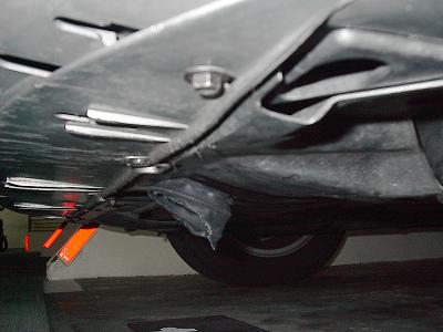

Andrewkb Neutral Newbie July 28, 2003 Author Share July 28, 2003 Here's the schema of my setup. Will post some photo soon. Need comments Link to post Share on other sites More sharing options...
S2P2 Neutral Newbie July 28, 2003 Share July 28, 2003 is this still the previous setup or a new one....sorry, dun really want to run through the thread..... if this is a new one and the one pointing out of the bottom is the same as your pic, it should be better than the old one....but questions, does it get hit when you go above humps? Link to post Share on other sites More sharing options...
Andrewkb Neutral Newbie July 28, 2003 Author Share July 28, 2003 This is the new setup. You notice that the snorkel is not connected to the main pipe. The previous setup is one whole piece. So, for this setup, I don't have to worry about water injestion. However, it does suck in certain amount of hot radiator air. Link to post Share on other sites More sharing options...
Silver_z 1st Gear July 29, 2003 Share July 29, 2003 You working for MoE?? The pipe is connected straight into your original airbox or are you using open pod? Link to post Share on other sites More sharing options...
Saaber Neutral Newbie July 29, 2003 Share July 29, 2003 maybe you can do a heat shield to block off the hot air from the radiator.... Link to post Share on other sites More sharing options...
Andrewkb Neutral Newbie July 29, 2003 Author Share July 29, 2003 Original box .... here's another pic ↡ Advertisement Link to post Share on other sites More sharing options...
