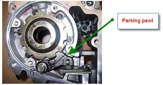

Wacko 1st Gear June 19, 2015 Share June 19, 2015 (edited) on a level ground, when the car has come to a complete stop, put into P, and release the brake pedal gently. the car will usually rock a little forward or backward, as the parking pawl catches the parking gear completely and sits snugly in the valley. then apply parking brake. my theory is that the car should be at rest without any internal forces trying to move the car in either direction. if you apply the parking brake too quickly, the parking pawl may be halfway into the valley, and there would be some forces still exerting between the pawl and the gear, which remains active throughout the parking period. doesn't seem ideal. Edited June 19, 2015 by Wacko ↡ Advertisement 2 Link to post Share on other sites More sharing options...
