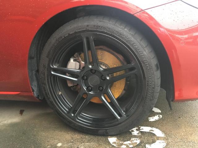

bellboy 4th Gear April 1, 2017 Share April 1, 2017 Need some guru advice. Some background. 1) My brakes has intermittent squeaking 2) My brakes has intermittent whirring noise 3) This is a Merc E-class 4) I sent it in to C&C for checks last month, and they claim to have serviced the brakes. Issues (1) and (2) did not go away. The below is photos of my brake rotors just 9 hours apart. Bright and shiny when I drove to office, and totally brown when I knock off. Is this normal? Is this what is contributing to my above 2 noise problems? Link to post Share on other sites More sharing options...
Gnahp Turbocharged April 1, 2017 Share April 1, 2017 Need some guru advice. Some background. 1) My brakes has intermittent squeaking 2) My brakes has intermittent whirring noise 3) This is a Merc E-class 4) I sent it in to C&C for checks last month, and they claim to have serviced the brakes. Issues (1) and (2) did not go away. The below is photos of my brake rotors just 9 hours apart. Bright and shiny when I drove to office, and totally brown when I knock off. Is this normal? Is this what is contributing to my above 2 noise problems? Photo 30-3-17, 9 01 30 AM.jpg Photo 30-3-17, 6 34 53 PM.jpg Photo 30-3-17, 6 35 23 PM.jpg it is normal, is is not the reason of brake squeaking most of the brake rotors are made of cast iron (except some Lotus with aluminium rotors and those uber expensive carbon ceramic rotors) , they will rust in a blink with the slightest presence of air and water. 2 Link to post Share on other sites More sharing options...
DC1977 3rd Gear April 1, 2017 Share April 1, 2017 it is normal, is is not the reason of brake squeaking most of the brake rotors are made of cast iron (except some Lotus with aluminium rotors and those uber expensive carbon ceramic rotors) , they will rust in a blink with the slightest presence of air and water. yep i have the same prob when parked outdoors esp. they turned brown n very visible after rain n sun. Link to post Share on other sites More sharing options...
Alg 5th Gear April 1, 2017 Share April 1, 2017 My brakes squeal also.......very loud. funny is only when I'm braking while reversing. New rotor, new brake pad. All original. Skim brake pad no use. Mechanic still say sometimes original brake pad not always good. Link to post Share on other sites More sharing options...
Gnahp Turbocharged April 1, 2017 Share April 1, 2017 yep i have the same prob when parked outdoors esp. they turned brown n very visible after rain n sun.those are surface rust, brake pads will rub it away on the first application of the drive. Link to post Share on other sites More sharing options...
