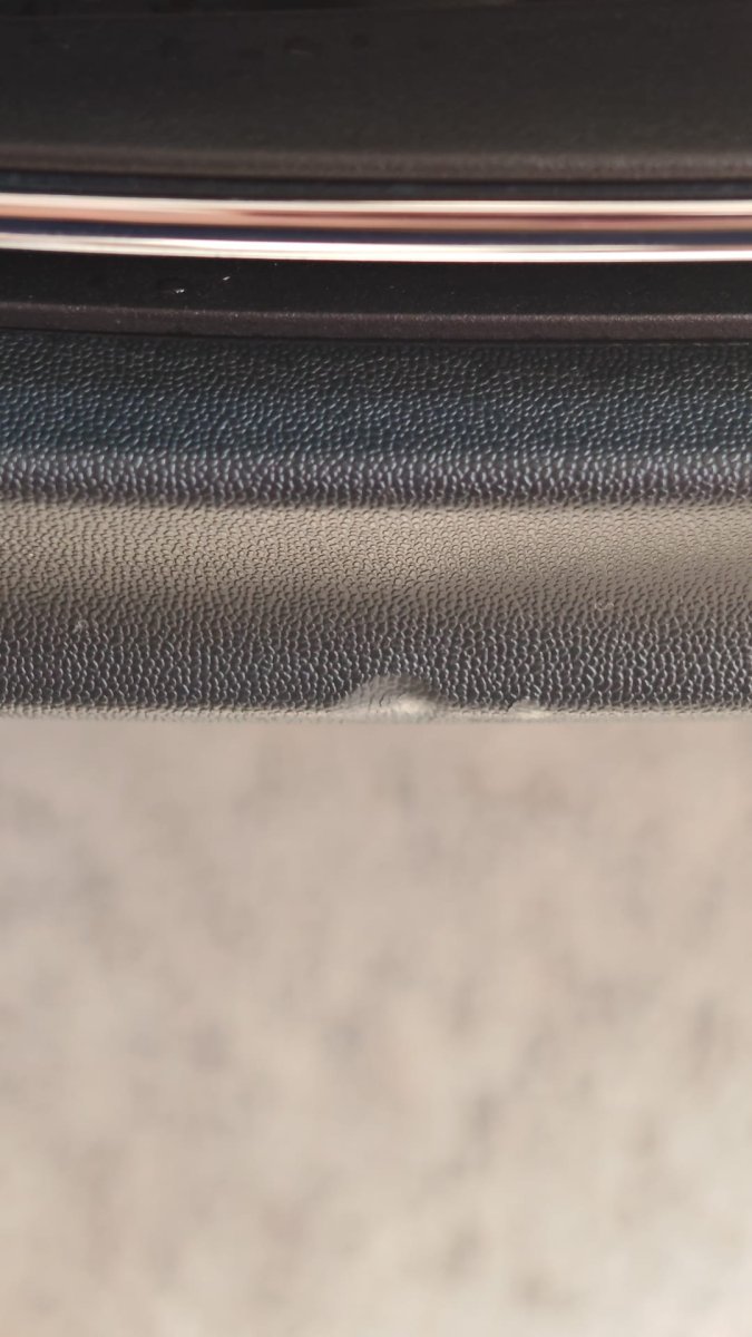

Onslaught 1st Gear May 24 Share May 24 Hi guys, Any ideas how to remove the dent on the front bumper lower plastic trim? Thanks. ↡ Advertisement 1 Link to post Share on other sites More sharing options...
