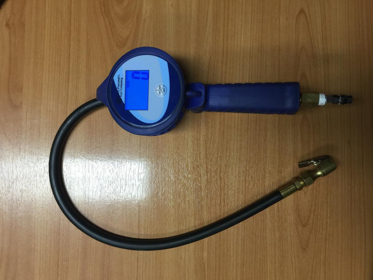

Fcw75 Hypersonic January 24, 2017 Share January 24, 2017 I disconnect the air input hose from the pump and connect to this, then I pump my tyres. Link to post Share on other sites More sharing options...
Yeobh 4th Gear January 24, 2017 Share January 24, 2017 I disconnect the air input hose from the pump and connect to this, then I pump my tyres. Be very sure to shut off the pre-set meter before you disconnect the inflating chuck from the hose. Link to post Share on other sites More sharing options...
