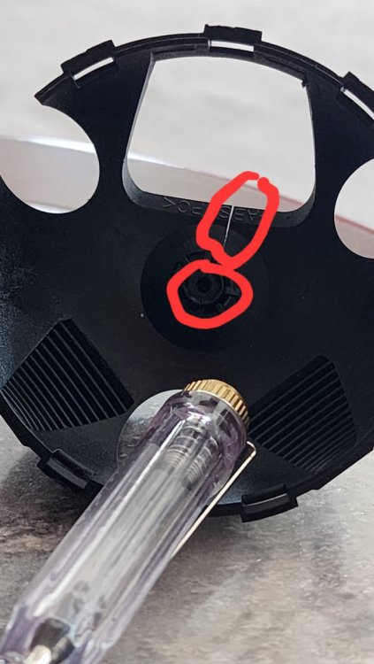

Ct3833 Supersonic August 9, 2023 Author Share August 9, 2023 Posting an updates on the structure of the side mirror adjustment gear assembly. The entire assembly housing consists of 3 pieces, they are held togather by just 1 screw. Open up the small casing by prying the small little clips at the edge carefully. You will see the two micro motors and some plastic gears in the small casing . One for horizontal and one for vertical adjustment . The micro motor can be dug out easily from the worm gear side, each motor has two small holes for electrical connectivity purpose. This motor can be bought from tao bao but the price has gone up, i paid less than $5 for my w211 about 7 years ago, now cost about $12 per piece. For my case, i noticed it is caused by a crack on the casing, it explained why it made some weird noise when in operation. So my decision to buy an entire assembly is correct😄😄. I will keep this old assembly for a few weeks, anyone keen to try or intend to salvage the micro motor can PM me ↡ Advertisement 4 Link to post Share on other sites More sharing options...
